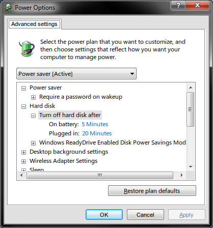

    Thanks for the quick reply, I see, this is the current power settings I have:
    It's set at 5 minutes and 20 minutes, should I change those figures? And more importantly, is that even the right place I should be looking?

    Yeah change that to more than 5 minutes, like an hour maybe or never (depends on your preference). Keep in mind that there is a different setting for each power profile (Power Saver in your screenshot).
