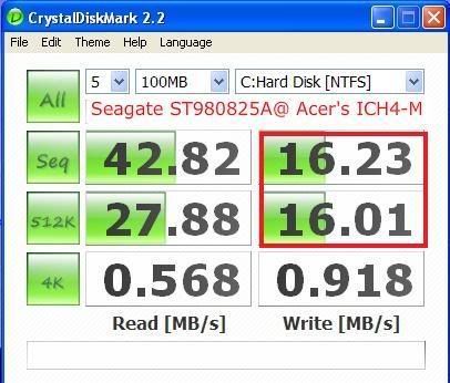

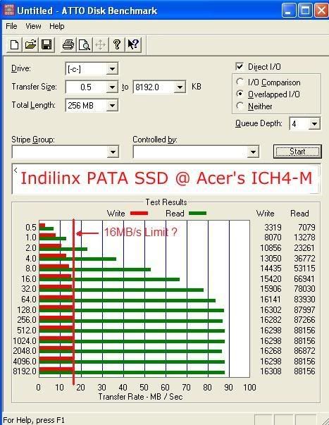

    Hi all,
    Again i hope someone out of the plenty members that this forum has, can enlighten me in the following matter :
    DATA :
    Acer Aspire 2003WLMi --> 855PM & ICH4-M
    WinXP Home SP1 OEM Installed & SP3 Upgraded
    Intel Chipset Drivers 6.3.0.1007 installed by "Have Disk" Method. These are the latest available for this chipset by Intel.
    Write Cache Enabled
    Ultra DMA Mode 5 for OS disk (only disk of system)
    PROBLEM :
    Well...See the following benchmark and tell me what you see (hint :write speed stuck @ ~16MB/s):
    [​IMG] [​IMG] [​IMG]
    The third pic is from an SSD, that is also stuck at just over 15MB/s Write....
    Well, i'm ready to read your opinions (and maybe questions for more info about my setup )....
    Thank you...

    @dondadah88 : The write performance is the same in every benchmarking programm i've used, i just chose 2 for example.
    @nando4 : The SSD is Indilinx-based with 64MB cache. The same drive on Thinkpad T40p ( same chipset with mine) has the following performance :
    The above is the same performance when connected to my desktop (Ati SB600 storage controller )...When in my laptop the write rate drops @ 16MB/s...

    I was expecting what i saw that this drive could do on a same generation laptop...I think it is not normal for my laptop capping the write performance....so i'm searching what could possibly be going wrong....
    This 16MB/s write bandwidth cap exists on my old hdd too...it is a ST980825A Momentus 7200.1 ATA drive...it should have at least 20MB/s write...so , as you can see the problem is not the SSD...
    Anyway...I am thinking of 2 reason's for that....
    First is that the Acer eRecovery installation of Windows that came with my laptop is crappy...I'll try with my Win XP Pro SP2 installation that i have from my desktop...this at least is not OEM installation...maybe OEM's change something, or i don't know....
    The other reason for that is maybe the outdated ICH4-M intel drivers...but at least they should work with my old HDD, giving same Write rate with the Read rate....
    Again....--->my problem is not the SSD's performance....this laptop also cripples the write bandwidth on my HDD...The SSD is just an example benchmark

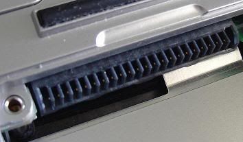

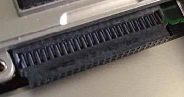

    Drive has no cable to connect. It has an adapter like this one :
    [​IMG] [​IMG]
    Do you think that maybe this adapter is holding back the write bandwidth?
