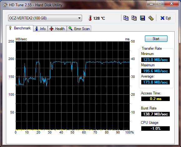

    I just put in a new SSD. It has this sandforce controller.
    I did bench test with HD Tune.
    Guess what? The results are horrible. About the same speed as a 7200 rpm drive!
    I already done the SSD tweaking.
    My other SSD on my desktop runs 2x faster than a 7200rpm hd, but not on this Sony Vaio Y.
    Something got to be wrong !!!
  10. #140
    Jul 2010
    Australia
    495
    Default Re: Official Y series 11.6 Owners' Thread
    The HD Tune result is highly dependent on block size. Are you sure you ran with the same block size in both cases? I think the default is 64k.
    For comparison, here are a couple of HD Tune results I got for my VAIO Y and VAIO F last year when I put in the Vertex 2 drives.
    First the VAIO F:
    Next the VAIO Y:
    The speed of a Sandforce drive depends on the compressibility of the data it's reading & writing. That's why the HD Tune results are only flat when reading unused portions of the logical disk.
