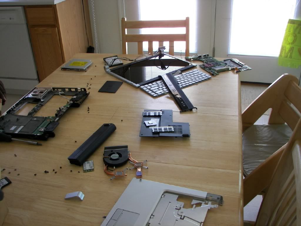

The tech guy fixed my laptop today.
He replaced the motherboard and I think the ram too. A relative of mine was there in my place, so I'm getting everything second hand.
The motherboard was refurbished. I have mixed feelings about that.
Here is an interesting picture:
I gather it is working well. But I won't know until I've used it for a while.
Ion

Yikes! I had to look away from that picture. I build PC's all the time, but seeing a laptop like that is like seeing a loved one torn limb from limb by feral pigs.

Awesome picture much appreciated.

The squeak is definatly from the hard drive. I'm wondering if the drive heads have crashed on the the platters so hard that it is barely letting the platters to spin (thus the squeak). I'd get the drive replaced as well.

Wow, that's ... lots of screws :P

If I ever do decide to have a tech replace my noisy DVDRW drive, I'm giving him a bowl for the screws... holy cow.

I've had many laptops splayed apart like that on my desk. It's a geeks best and worst moment.

Is it just me? I would be pissed if I saw a tech do that with my laptop. Maybe me being a tech myself. But to me that just looks careless. That is how stuff gets broke/scratched/missing screws. Regardless of how good the tech is that did the work. Regardless of how nice he might be. If it was my laptop I would have sent that picture to Dell.
There is a very important term and procedure in cooking, called Mis en' place which means "Put in place".
Anyways, I am happy to hear that your laptop got fixed

The tech guy who worked on mine was just about the same, but I always am very careful with all the screws. I guess they do it a lot, so they don't need to be as careful.
