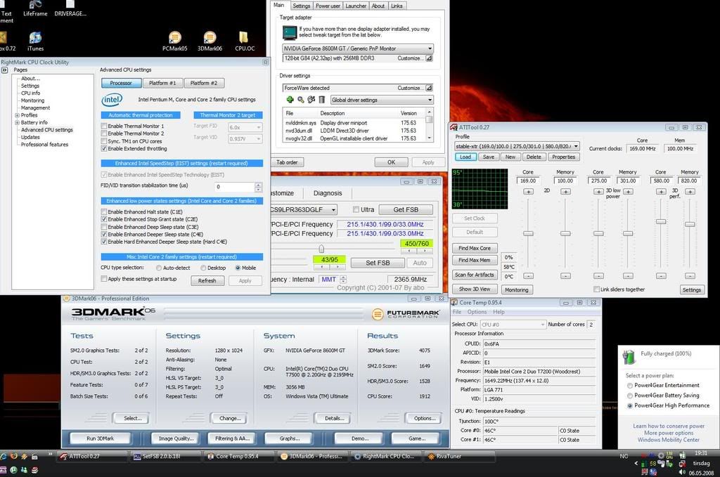

Guys , test this please , it's working here !!!! USING RMCLOCK 2.30 remove those options, choose mobile cpu, apply and test it
Below is benchmarks on the difference between having Thermal Monitor enabled or disabled during recharge.
PLUGGED IN RECHARGING FROM 80%, 167.45 driver
Ok here is some results for how the score when the pc is recharging with and without "enabled thermal monitor". The theory is that with the default settings (enabled) the CPU should loose performance compared to when thermal monitor is not enabled while recharging.
BEFORE TEST, same OC as above, 80% battery, RECHARGING
AFTER TEST, charged to 85% battery. *NOTE* CPU SCORE 1702! when it was full battery it scored 2079!
OK Here is the results when Thermal Monitor is DISABLED.
BEFORE TEST, same OC as above, 80% battery, RECHARGING, DISABLED THERMAL MONITOR
AFTER TEST, charged to 83% battery. *NOTE* CPU SCORE 2058! This proves that by disabling the thermal monitor when your battery is recharging the CPU will NOT lose any performance. The battery has also recharged 2% less then when thermal monitor was enabled, this indicates that the CPU has had priority instead of recharging the battery.
So we can conclude for now that you loose an important amount of performance when your battery is below 90% and recharging. The CPU score went from 2079 to 1702 when it was recharging. By Disabling Thermal Monitor it did however climb back up to 2058 CPU score. The battery recharged less and the temperature increased 2-3c. I also want you to notice that the CPU score is THE ONLY score that varies when the laptop was plugged in with full battery and when it was recharging, the other 2 scores where more or less the same! This proves that it is the CPU that loses performance and NOT the GPU when you recharge your notebook.

PLUGGED IN FULL BATTERY 167.45 driver
BEFORE START UP:
AFTER FIRST RUN WITH STOCK CLOCKS DRIVER 167.45
First i want to say is that it never went above 85c. The highest i saw was 80. This is with default clocks 475/700 and the 167.45 driver. I will now run it again with overclock. 3907 is btw a good result for a G1S with stock driver / clock.
This is results before and after with OC. I seen the temperature hit 90c with this configuration.
BEFORE START UP
AFTER SECOND RUN WITH OVER CLOCK 580/820 + CPU 2365mhz. DRIVER 167.45
Conclusion on the 167.45 driver
This driver works well and i did not experience any stuttering. However i do have proof that the stuttering issue remains in the 167.45 and the latest 175.63 drivers. Look at the bottom of OC section for the results when the GPU reaches 90c, 95c and the magic 96!
PLUGGED IN FULL BATTERY 175.63 driver
Well i am happy to say that i did get a better score with the new drivers, 100 points better in fact. With the 167.45 driver i got 3907 and now i scored 4075 with default factory settings. The new window in the pictures below is rivatuner, just to show that the driver has been updated.
BEFORE THE TEST, factory defaults plugged in.
AFTER THE TEST, factory defaults plugged in.
And here is the grand finale with the overclocked 175.63 !
Before the test, OC, 580/820, 2365mhz, thermal disabled.
After the test, compared to 4731 with the 167.45 we now reached 4948!
Stuttering due to High temperatures and its effect
I made this test really simple, i ran AtiTool, overclocked the gpu to 580/820 and had it show me the 3dwiev which forces the GPU to use its maximum potential. The results are very easy to understand as you see the AVG frames rise until the temp hits 95/96 then they decline again. On low temp the avg was 344 frames at max and when the temp got to high it declined to 269. I could never get the temperature above 96c.
At first here you see the frames at 340 AVG and the temperature increasing steadily. At the top it was 344 and 95c.
On the second image here we see the temp when its reached 96/97c and that the AVG frames is starting to decline.
On the third image it is quite clear that it will continue to decline until it reaches lower temp levels.
And on this last image i have reset the AVG counter to show the real-time effect and not the avg from when the test started like the above shows.
Conclusion on the 175.63 driver
This new driver has given my laptop a performance boost of 100 - 300 points depending on when its NormalClocked or OverClocked.
I did also run the OC setting on 1024*768 one time and it gave me 6149 score. This would explain how WEissbr0t managed to get 4739 on default clocks.
Note to all people who wants to run 3dmark06, the results you publish should be in default settings. If not you should notify the readers.
The 175.63 drivers gave a performance boost, but not really what i had hoped for. I had no stuttering issues during any of these tests. The temperature was steady below 90c.
The provided Images of ATItool should prove that stuttering occurs above 95c (at least in my laptop). Earlier its been said that it occurs at 90c, maybe they increased the max temp before it throttles down to 95c in the newest drivers? - i cant answer that one, id have to revert to old drivers and do the test over again and i cant be arsed! Stuttering occurs at approximately 95c. It lowered performance from 344 fps to 269 fps which is a 27% decrease in performance.
Here is a image of the 1024*768 results
