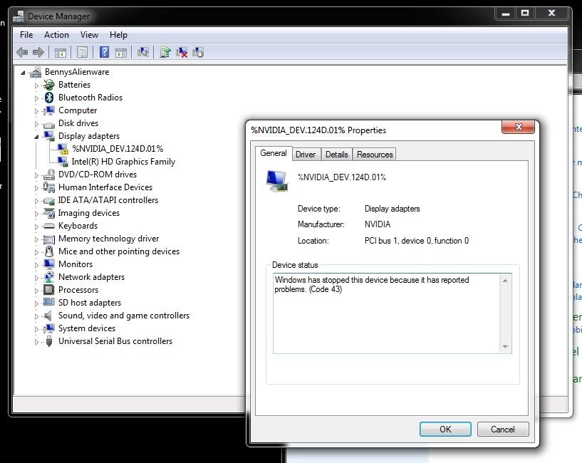

    Update from my saga. I have been talking to the Dell tech for 3 days now, they seem to believe its a software problem, there was a new batch of 3.0gb cards released and the driver .inf files weren't updated to accommodate this particular card.
    Sadly though, I have tried 2 modified .inf files sent to me from the Dell Tech, (open .inf in text editor, add Hardware ID profile for the card, replace original .inf with modified .inf file) , this lets the Nvidia driver see the card and install the driver, but after a restart I see this ..
    Every time I think I might have success, I get this wretched (Code 43).. I am also a little concerned about how the Dell tech edited the .inf file, you can see the "%" symbols in the name of the device... If it were edited correctly and cleanly , it should just read "Nvidia GeForce GT 555M"

    Just spent 2 hours on the phone while Dell remotely tried to rectify the problem I am having.
    They essentially did exactly what I have been doing for the past 5 days, modifying the .inf files for various versions of the Nvidia drivers , adding the hardware ID for the card version in my laptop, and then installing the drivers with the adjusted .inf files.. to no avail.
    I questioned how this can happpen, Surely Dell would not release video cards unless the driver software was tested and available for consumers to utilize ? .. He explained that "Nvidia constantly leave their new card model numbers out of their driver updates..." Not very reassuring.

    ive tried the modded inf from laptop2go and it DID in fact install...BUT only when selecting "have disc" and choosing the gt555. nvidia software did not install because it still said no compatable.
    ben gave me their modded .inf files for 2 different versions of the drivers...the 285 and one 290.36 i think. 285 was the only one that took...but basically you replaced the nvdm.inf file with dells custom one and then click the setup.exe and viola, all nvidia stuff takes and installs.
    but heres the problem, after it takes, i have the ability to open nvidia control panel but settings do absolutely nothing because intel is still over riding and is in control. so, i opened device manager (no "!" errors) and i disable the intel driver and the screen goes black and nvidia never takes over.
    i went back into update driver and "let me choose" then in the diag box it still shows standard vga and then under that it shows the %%%%%nvam%%%% looking file.
